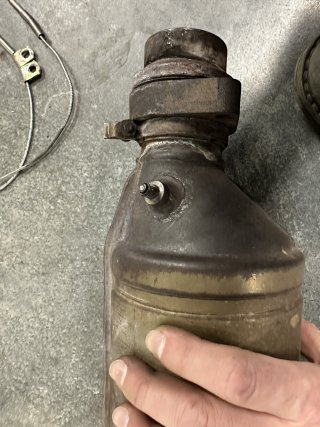

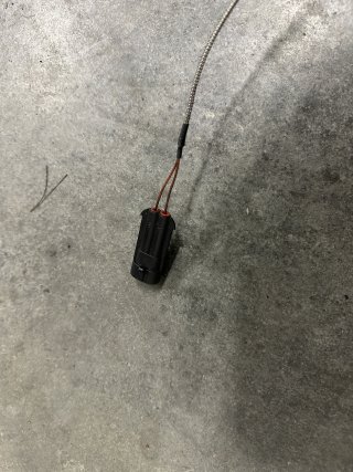

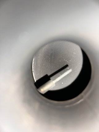

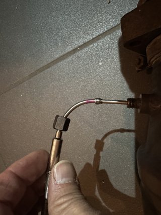

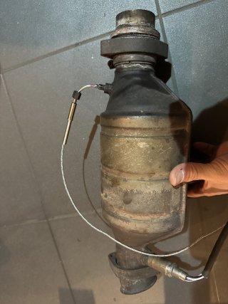

3. One thermocouple for the exhoust was broken. I was trying to take it out from the CAT, but it broke in half. Need to drill the old part I think. I did buy 3x100mm K thermocouple for about 2 Euro (aliexpress), let see if that works :D
It was not so easy to take out the old thermocouple. It ends up with taking out the Cat.
But... I can confirm, thermocouple K 3*100 mm from china for about 2€ works :) Ferrari used universal 2pin plug, which is easily available.
Exhaust completed, thermocouple works like factory. Even the universal plug fits to Ferrari factory clip.

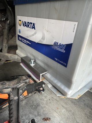

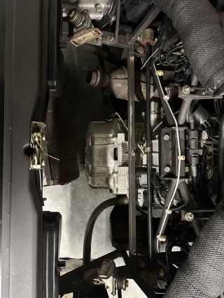

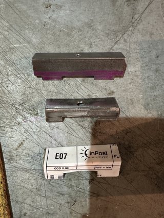

Next small task was the battery tray and assembly bracket. My original battery bracket was missing, so I decided to make one. Of course you can buy original for £40 but adding shipping, custom duty, taxes it will end up around £60. For me to much for a piece of steel.
Bracket evolution. Paper model, prototype and the final stage.
Just need some paint.

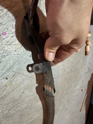

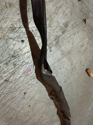

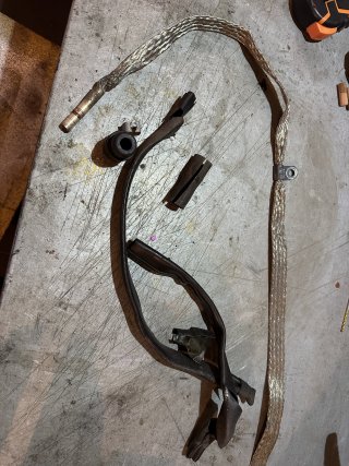

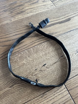

When I was in the battery area I found, that the main ground cable is not on the perfect condition.

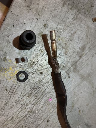

I was able to strip the original isolation, remove the factory plug

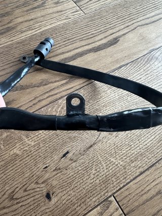

And with the help of 2 new heat shrink tubes the cable is a brand new again :)
Definitely worth doing, it seems like many electrical snags on these cars are caused by bad earth connections of one sort or another.
