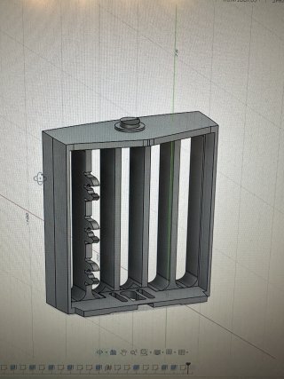

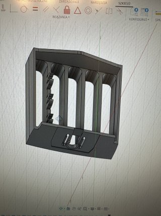

My sides airwents on the 348 was not perfect. The luwerse were broken so it was not possible to regulate. The used almost not possible to buy, new not available.
Work in progress for 3d print.

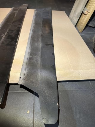

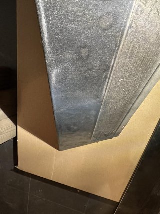

Thaw was a log jurney :D Everything starts 2!! years ago. The kick panels has a bit of rust, some scratches, so I decide to take care to look good.

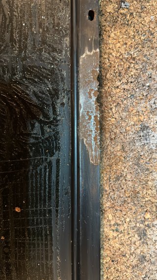

Small corosion was repaired, and then by sand blasting the surface was damage :/ I had no idea what to do with that, so it was waiting and waiting and waiting...
87ed338e-34c5-48eb-9459-17e882e73e2c.jpeg 50D1523F-BC0E-4967-9540-963AB7DF55BE.jpeg

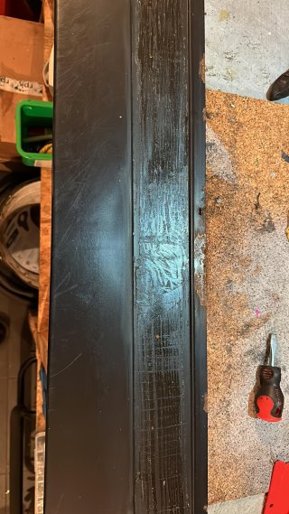

With a heat torch, hummer and cold watter, I was able to make is the best possible (I'm not a profesional).
att.QvdQU_e-ZzlQa6ptRMKFw0G465RjimA8ALinCWCrWvQ.jpegatt.pqi99Ksz8gmKXlZTm7VMbPOJVNV8JJEu-srqQ41JMKc.jpeg

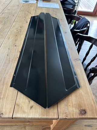

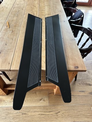

After that everything was painted. I told several times: matt black, and I get shiny :D Nevertheless looks much better that on the beginning. With mat PPF I was able to achieve pretty good original look.
