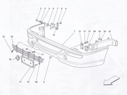

I shall do the write up when its all done. By the looks of it its as simple as the rear. But the rear is held on by 8 nuts, 4x13mm and 4x17mm. The trick with the rear is to jack up one side of the car a little to undo the 3 screws that hold the rear section of the wheel arch inner cover. This is done to get at the two 13mm nuts. Then do the same the other side. By the looks of the picture the front bolt/nut system is the same, and thats 8.
So thats why i asked about any tips regarding the front bumper. Its all handy to know. But if i do it with out tips then like i said i will make a note of them and post up.:thumbsup:
