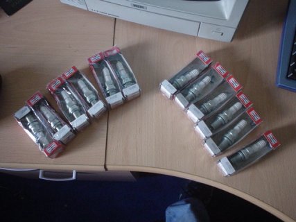

What are the choice spark plugs for a 2.7 car? The WSM shows RG2 PHP (cannot find those on the Champion site) but what is the latest/best to use? Thanks.

Spark plugs can be a personal thing, since the RG2 PHP plug Ferrari have gone over to NGK (PMR7A) plugs.
I've always rated and used NGK's,will check that the PMR7A is the right plug for the 355 for you tomorrow.

it is the right plug steve.
