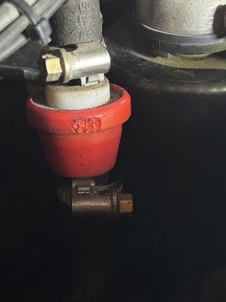

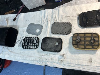

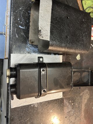

2) Ive always had a bit of gas smell; and sat on the parade lap at Silverstone it was particularly smelly; and Giles noticed, so cant have that. I looked to replace the valves and charcoal filter in the evap system. The valve is available but at £139, for what in reality is a £2 part. I opted for the valve from a 5.2, which is £8, part 174594; noting Superformance list it for the 2.7 and 5.2; and the shop manual list them with the same pressure spec! Seems to have sorted the problem; but Ive only done a few miles. Taking it to Silverstone for the F1 next weekend so will know more then.
Some pics below including inside charcol filter.
