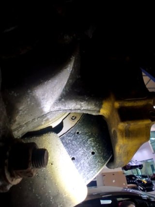

1) Rear disc pins broken off . Require replacement with pads. - There were no warning lights prior to the car being entered into service. I Have attached the photo that highlights the problem. Quote to fix with OEM parts is almost £9K presumably plus 20% VAT. They have also suggested replacing the fronts at the same time (Of course) at a cost of £9.3k because - "Front discs at 70 % worn recommend replacing with pads as rears need doing"
My questions,
a) Has anyone had experience of the lighter Girodisc conversion for this or other Ferraris as it would be significantly cheaper for me to go down this route.
b) Is it dangerous for me to dismiss their quote and drive the car (conservatively) until I get the Girodisc conversion done.
c) Any advice on a competent supplier that can fit the Girodisc conversion in the U.K. would be great.
d) Am I being silly and should just go with their quote.

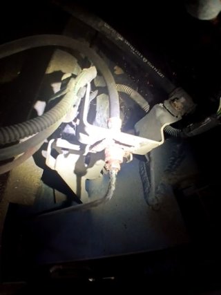

2) Rear left hard line corroded. Quote for fix is about £700 plus VAT.
Question is, does it look that bad to warrant replacement?

Based on some research I've done, I should be able to get an independent to just replace the pins. Much cheaper solution.

Well the absolutely fantastic news (for anyone that finds themselves in this position) is that Autofficiana have developed and manufactured their own solution to the problem. New pins which they can install and don't suffer from the manufacturer's fault. Cheap solution, I get to keep my FF CC discs stock and will soon be booked in. Very Happy :love:.

Just an update. Autoffincia did a fantastic job. All the retaining pins are now replaced with their solution which does not suffer from the manufacturer fault. Very reasonable and excellent service all round.

Indeed, that's probably why one of my brake lines corroded (thankfully remedied by Autoficcina who made up a bespoke line again at a very reasonable cost compared to what I was previously quoted).
