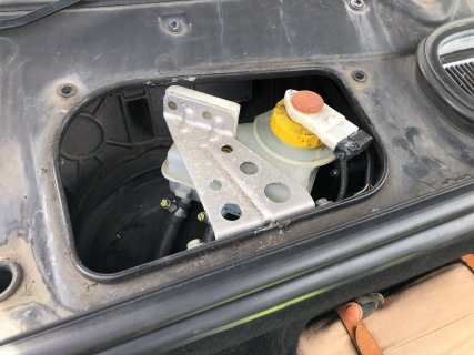

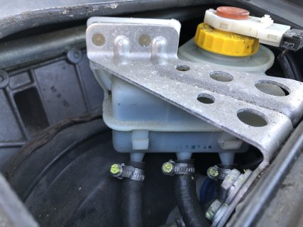

I’m also losing clutch fluid from somewhere, I suspect the clutch block, again an item that have been replaced a few times. It’s a little disconcerting after a motorway stint whereby you come to the toll gate and you don’t have a pedal. It soon pumps up and the pedal is restored but it means I’m losing fluid so I have topped up once and so far not had to top up since. Every fuel stop I’ve been checking the level. I guess it’s good learning to know that a lost clutch pedal isn’t the end of your trip and it will recover as long as you have fluid in the reservoir. I will remember to check the brake fluid level more often on future! I wonder if there are any issues with running the vehicle without the cover/ inspection plate, is it just cosmetic or does the plate perform a function?

Brake /clutch fluid empty…..
And topped up……
I topped up after day one and so far it hasn’t needed more even after 1,500 miles, but as mentioned I’m checking at every fuel fill up.

Sam has not found where I’m losing my clutch fluid as yet but it could be the master slave / servo unit. He will keep me posted.

So the big unknown is the clutch fluid loss…. It’s going somewhere, Sam just needs to find it! :D
