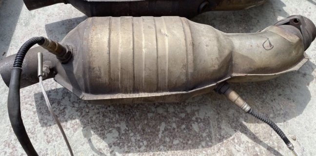

While doing some cleaning on my 488 in the garage requiring the doors to be open I had left my 360 outside as the storm swept in, I thought it would be fine like it normally is, but not this time.
It was the morning of the Classiche event at Graypaul our local main dealer and I had booked an inspection of my car so I was keen to attend. On start up I immediately thought it was firing on 4 with a bank down but I thought it would dry out and be fine. I was wrong, and critically the car did try to tell me. Engine warning light on which is unusual for my car, I rarely get a MIL and if I do it gets sorted quickly - ususally it's something and nothing. However this time it was something and somthing significant. Driving 3 miles up the road the car was still down on power and it was doing a cycle of steady MIL and then flashing MIL, then it was the dreaded 'SLOW DOWN' message followed by a loud bang and the car sounded like an unmuffled race car, so I stopped. The engine bay was on fire(!), although that's hamming it up a bit, it was nontheless true. The LHS catalyst was glowing cherry red and bits of it were falling on to the undertray where a little bonfire was building, literally a pile of bits on fire, flames and all! I had a bit of drinking water in the car so chucked that on and it extingushed it immeadiately. Crikey!
The upshot was that the car got relayed to Sam at Stradale Italia and as it happened, I flew out to HK for a holiday!
On return from Hong Kong the car wasn't fixed as some extra bits were required, so in total this is what it had:
A good used OEM cat complete with Lamda sensors, a new OEM thermocouple, new OEM injectors x4 and 2 new OEM coil packs.
The long and short of it is that yes they can survive in rain, but a severe storm will get water into the coil packs/spark pugs and a bank will go down. The really annoying thing is that, had my car not been parked out in the rain, and it normally is not (a car port at home and in a secure multi story car park at work) then this just would not have happened. Equally if I had not been a complete idiot and ignored what my faithful 360 was trying to tell me, it also would not have happened! Oh well, we live and learn and it has survived to tell the tale, just at a cost!
The good news is that my tech believed that the car was running lean on the left hand bank and with the new injectors this has been resolved and it is running better than ever, much more smoothly wothout any pull away torque holes which I thought previously may have been the calbration but now seems more likely to have been fuel delivery.

Burnt out catalytic converter
Good used cat

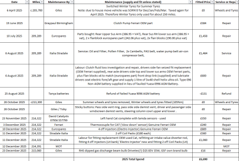

Yearly update on costs etc....
Breakdowns: 1, water getting into 2 of the coil packs/spark plugs on the left hand bank, throwing unburnt fuel down the exhaust which burnt out the cat - see above!
Warning lights: 1 which I ignored, which was a big mistake, huge. (as Julia Roberts would say!)
Costs: £6,690 An expensive year because of my stupidity! Next year will be nice and quiet I'm sure! (have I said that before?)
Miles covered: Just under 10k

(Looking at the photo of the good Cat, it has an R on it so that might be a 'library' image from the ebay advert as he had a few to sell)

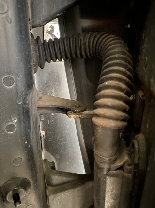

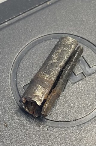

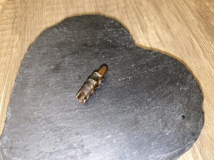

On opening the drivers door I heard a very loud crack and something fell out of the car, ooh heck I thought!
On inspection I thought the door check strap had given up but it was the roll pin…
Luckily they are £3.92 from the dealer which consists of a hollow roll pin (sprung tube) with an insert you knock in.
Sam at Stradale Italia fitted it (well mine hadn’t arrived so he gave me one of his) and he didn’t charge me either, I gave him ‘a drink’ and we are all sorted once more.
It was so disconcerting not having the check strap so I was so chuffed this not only was fixed quickly but also the cheapest fix on fail I’ve had! 😀
I’ll try to post some photos.
