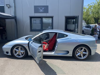

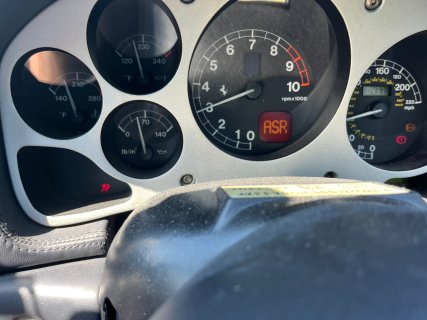

So my mechanical problem presented like this…. the following morning after the dash into Germany I fired up the 360 but with the ASR and ABS warnings lighting up which I thought was unusual but not unheard off, usually linked with low battery voltage but in my mind I was thinking that I had just done a long trip….. then the battery warning light came on, then off, and then randomly on and off….. so I knew I hadn’t thrown an alternator belt or it would have been on solid…. so I continued on to Austria. On the approach to Munich the battery light started flashing (but I noticed at speeds above 55mph ish, below which the flashing light went out.

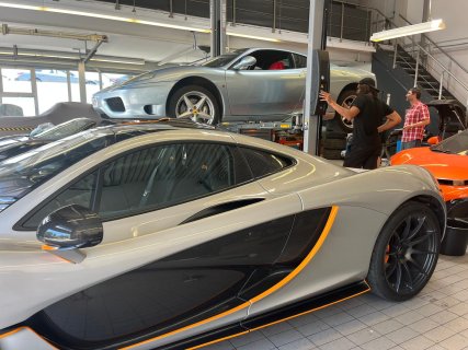

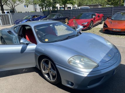

A quick Google identified the Supercar Garage in Munich being a good shout, so a quick update of the nav and we were heading to an unknown but well reviewed garage.

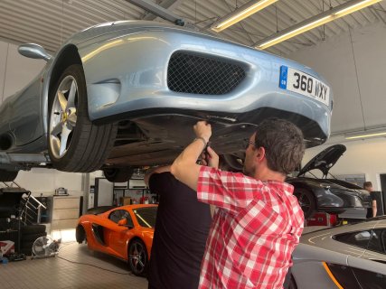

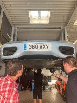

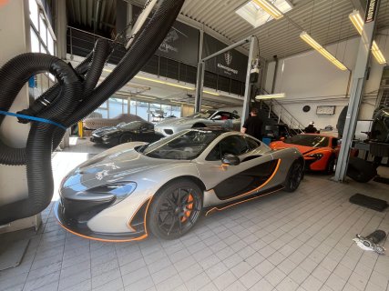

The guys there were stacked with cars (inc a McL P1, Porsche 959, Lambo M, 458 and 296) but they jumped on my car straightaway.

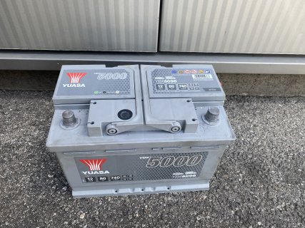

They quickly identified my battery as being toasted, 1% state of health but with 100% state of charge but critically at very very high (dangerously high) temperature.

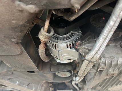

So the workshop Manager Oliver gave me a lift round the corner to buy a new Bosch battery. New battery fitted, and while being tested they found that above about 2.2k rpm the 13.4v charging rate jumped to 17.5v, essentially over charging the battery, causing the excessive heat in the battery, conclusion the alternator was knackered, well the voltage regulator was toast requiring a new alternator. These cars run a Denso unit with an internal regulator so it can’t be easily fixed.
The guys at The Supercar Garage have sourced one (about €250, which is better than the main dealer quote of €940!) and will be delivered either today (which is the day after the breakdown) or tomorrow. So hopefully all in hand, but we will see! By the way I’ve also lost my clutch pedal after motorway drives but a quick and frantic pumping of the pedal gets it back, admittedly this is not for the faint hearted. If they can spot something they will try to resolve but I’m happy keeping an eye on the clutch fluid level and rapid pumping when needed. I’ve just had a new clutch cylinder so it might be the thrust bearing washer seal or suchlike but it’ll probably get me home.

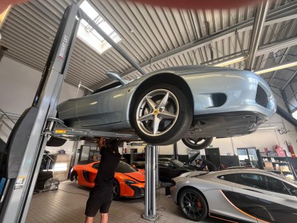

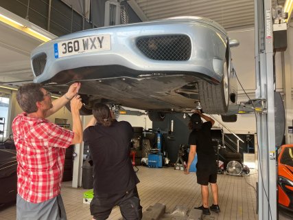

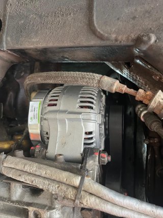

360 is now fixed, well the alternator (or generator as they say in Germany) at least, so I’m mobile again 👍
The guys at The Supercar Garage in Münich were superb, so if you need service in this neck of the woods, these guys are the place to go.

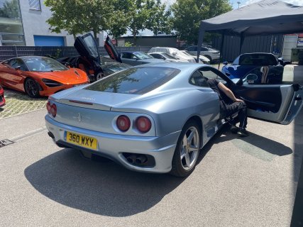

Oliver the workshop leader travelled for around two hours to pick up the new alternator so he could fit it today, that really is going over and above.
I did take the opportunity to get the front undertray off to see if I could find out where I’m loosing clutch fluid but it was indeterminate.

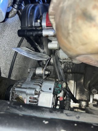

Some snaps of the new alternator going on.
Back in action 🤩

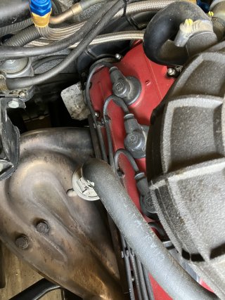

Was the old alternator covered in oil ? Thinking weepy cam seals and drips on it .
A good hard drive will extra soak it .
I noticed it with my 348 , a slight weep drips on the alternator, more cam cover seal at the corner ( known 348 foible ) .
So I made a little shield out of alloy to protect it .
I have cleaned it up , but if left I suspected the alternator would have an early death .
Hi Silver,
Thanks for the suggestion but I think it was just old age, there is no suggestion in the history it has ever been changed so it’s had a fair innings!
I have the alternator and it’s not covered in oil, the failure is the voltage regulator which according to Google can fail (super conductors) under very high temps. That is plausible following my quick whizz up to 140mph (indicated) in a 36 to 38 C ambient.
Either way, I’ll get the alternator reconditioned either to sell or keep as a spare.

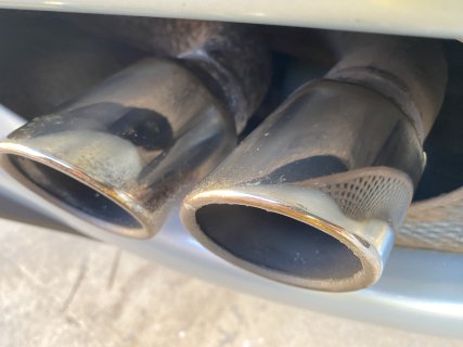

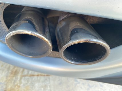

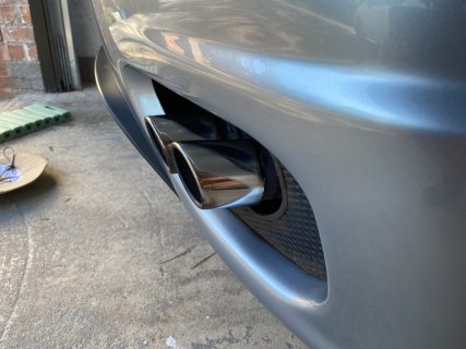

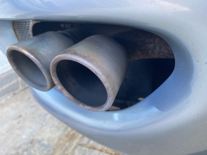

I also removed the exhaust drip stains from below the exhaust tips (required t-cut) and being at such close proximity to the tips, they looked horrendous so I’ve done a rare costmetic improvement and polished my tips!
I appreciate my after photo might look like your before photo but I can assure you it’s a huge improvement!
Before (well, that is the tip on the right, the tip on the left i gave a quick tickle the other day, where is Sid James when you need him?!)
After
RHS
