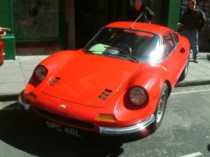

It retains the original vinyl interior fortunately. Photos herewith (hopefully!). Let me know if not clear enough and I'll take some fresh ones. Thanks again!

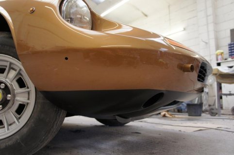

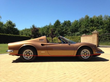

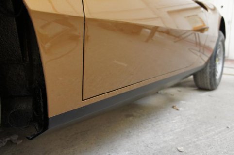

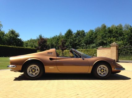

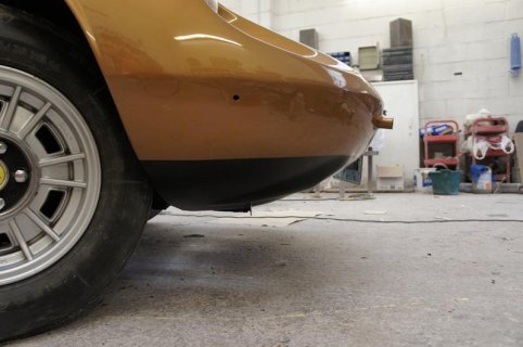

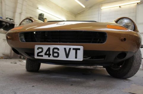

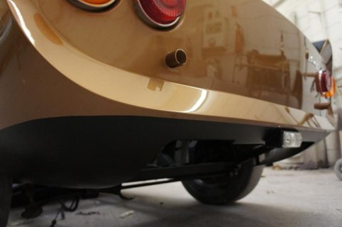

It is a late model E series Chris so the lower satin blacking goes higher. The line along the side of the car comes up above the crease on the sills and stops roughly an inch from the doors. On the front it runs around just above the front air intakes. At the rear it sits just above the surround for the reversing light. Masking it all up correctly takes a lot of time and patience to get right on both the front and rear clips. Here is my GTS for guidance which has the lines at the correct levels for your car. If done correctly when viewed from the side the lines on the side of the front and rear clips should look like they flow from the line along the sill and describe a gentle arc as they rise up which I've shown in red on the last photo.

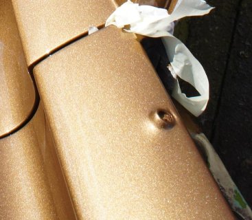

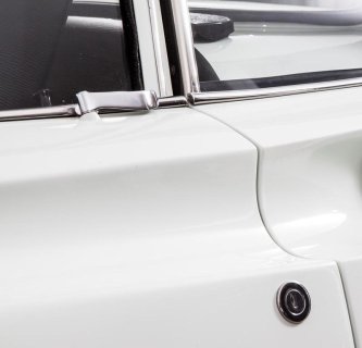

Looking at your photo's it would appear your front indicator lenses are not seated correctly which could mean either the sealing gaskets are worn or missing. The lenses should sit flush with the nose panel. I can't see your exterior door handles but on many cars that have had repaints the carefully sculpted ferule that holds the top of the handle in place has been lost by over aggressive machine sanding of the panel when removing. Re-instating them takes a lot of skill by an experienced metal panel worker and they should look like the ones on these photo's.

Hi Iain, many thanks for your detailed and most informative reply. I clearly need to advise the painter of these various points.
The small black stickers are on the external door panel, right under the door handles. I can only imagine they are there to protect the paintwork from damage from sharp fingernails whilst opening the doors. Are they correct or has someone added them at some point, perhaps for that reason?
