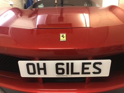

Hi Folks,

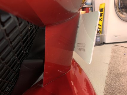

Front numberplate….
Ok, on my original 488, I fitted the Carbonio clamp on numberplate bracket, it did exactly as described, held tight, without drilling/damage. It did however cost about £300 or more with the import tax.
So…. I have been trying to get hold of the OEM plate plinth bracket that requires the bumper to be drilled, it appears that most people junk these on day one of ownership!
I’ve played with a few ideas, but come up with the following centre mounted plate.
Comments on the letter spacing is prohibited! 🤣🙈
The reasoning behind, ‘will it work?’, goes like this….
You might think the middle of the plate where the ‘61’ is might get pushed in with the strength of the airflow at speed. However I think this area will be the stagnation point, essentially at that point the airflow is separating outboard towards the side (and downwards) of the plate/vehicle, so if anything, the O and S Will be the areas taking the load but crucially the distance from the end of the plate to the bumper vertical section where the double sided tape is fixing the plate is short enough not to deflect. Evidence for this is that the Carbonio clamp on plate mount is narrower than the vertical mount points here.
Time will tell and I will keep an eye on it.

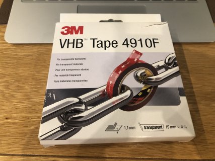

The main reason I use this 3M tape on all my plates is the simple fact that it doesn’t leave any tape on the bodywork when you switch back to the original plate. The number of hours I have spent taking old foam sticky pads off bodywork, very frustrating!
If this works, it’s a good solution to that daft question, where do you put your plate? Loads cheaper than a Carbonio item too 🤩👍

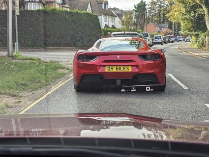

I was spotted today by one of my friends in his cherry red Panamera eHybrid and was promptly sent this…..
His comment was something along the lines of nice rear 🤩
I think the back of the 488 is more tidy than the 458, but still think that 458 front end is super sharp with those cuts/vents inboard of the headlamps.
Front numberplate update:
I strongly *suspect* that *if* you travelled at double the U.K. single carriageway speed limit it would not fall off, just a *hunch*, purely *speculative*, who knows? 🤣👍

Personally prefer front of 488 to 458. I think the 488 looks lower, wider and more aggressive from the front. It’s really noticeable when they are sat next to each other.
I'm nit picking, love the look of both, but I agree with the above.

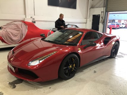

Hi Folks,

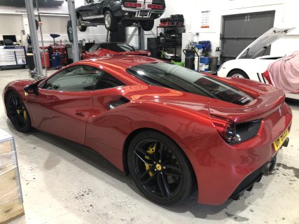

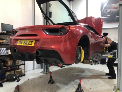

Spring swap time 👍

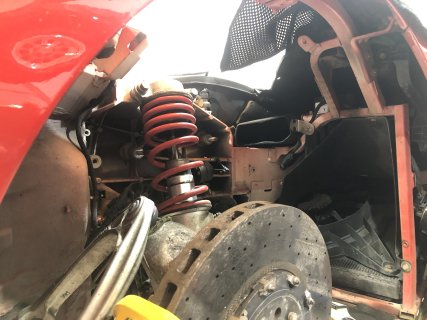

H&R lowering springs (red) have been taken off and the standard springs have been fitted (black).
Red springs to be removed.

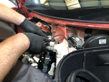

Black springs fitted:
I questioned all the body sealer around the base of the windscreen and inside the wheel housing envelope, apparently they are all like this, not particularly elegant under the skin!
Wiper mechanism / motors were removed so a fault code needed clearing.

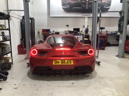

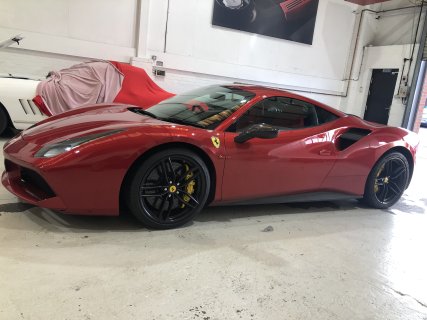

Ready to go 👍
Next job will be to get the geo checked and corrected if required, off to Damax Engineering for that.

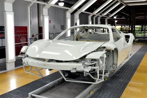

Here in body-in-white with closures. What appears as headlamps are the side pod air intake splitters, interesting as mine are carbon, maybe every car gets painted splitters and are switched out for the optional carbon ones if specified?

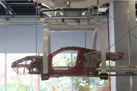

Out of paint, pre closures refitted.
I guess the process is BIW (body-in-white) complete with closures, then it’s closures off, and through paint as separate items to be refitted to the BIW later.

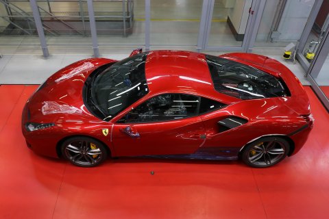

Then, this is, I guess, post T&F (trim & final) on the quality assurance line pre ship complete with protective transit wrap, or could be before/after track test drive?
I note the rear deck tricolour/tricolor Italian flag badge isn’t fitted at this stage. Could that be a dealer fit item?
The wheels are the option Forged Matt Grigio Corsa rims, I plan to return these to the as factory finish as soon as I can find someone confident they can replicate the finish/colour.
Great spec, looks superb in this as-left-the-factory livery. My ridiculous mirror carbon wrap needs to go too!
I think the tricolour badge must be fitted after this stage, because it is missing on my build picture too, but it is on the spec sheet and the car!
