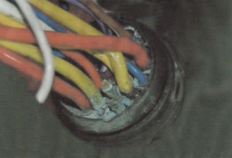

As well as taking the advise offered above I would recommend that when you remove the door panel I would check the connector shown in the picture, very common fault - also effects door warning light, speakers and central locking. :wink3: :wink3:

Agree with Mal. If the side on the door seems fine, you have to remove the wheel and the the wheel guard to investigate the other end of the connector. Probably a loosen wire or bad contact. Clean or resolder them. had that on my 348. SOme people just did a straight connection and bypass the connectors. Hope this helps. :)

I'll get it on axel stands and whip the wheels off and take a look - that will probably be easier to check first than stripping down all the doors and window assemblies.
