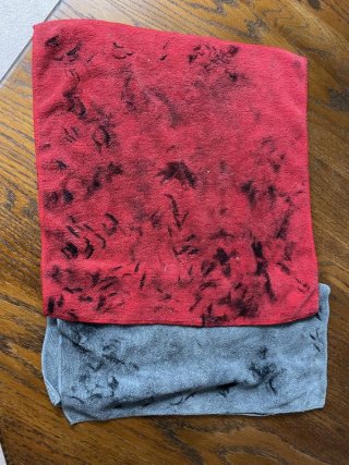

Myself and others have shared various methods for dealing with sticky vents, panels and switches etc. My vents were fine but recently became sticky this year so needed attention.
During various net surfing I came across a recommendation for Dunlop 65 which is used to clean the fret board on guitars so I thought in the first instance I would give it a try. I don't think it has been mentioned here so I thought I'd post a couple of pictures for info.
I found that it did the job very well. A wipe with the fluid from a microfibre, left for a few minutes would soften just enough to transfer onto the cloth with a firm rub. Repeated a number of times over a hour or so would have it all off.
The fluid is gentle enough not to damage the plastic or flow onto unwanted areas. I did not let it flow into the recess where the arrows are marked so the recess area was untouched.
The resulting finish with the soft touch coating removed IMHO is good enough to leave as is but could also be sprayed with black satin paint if required.

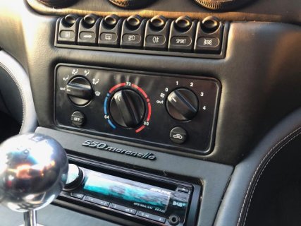

Spent yesterday afternoon 'de-sticking' the switches on the dash and door/mirror controls on my 550.
Well pleased with the results, thanks for the info Terry :thumbsup:
How did you manage it - did you take each switch out in turn? Any specific tips for the 550?
I removed the heater control panel by using a flat bladed screwdriver to prise it out. Just the single cable connector behind. Gently clamped in a vice and then sprayed the liquid onto unit and left to soak for a few mins. Tried rubbing with a cloth but that was very slow so tried a sponge scourer. Took some elbow grease and sore fingers. Finally dried off with a micro cloth then a good blow dry with compressed air.
With the switches they were not as badly affected. Again a flat bladed screwdriver to ease them upwards so they can be unplugged. Their faces were OK so only required clean the small switch part. The electric window controls on the doors were left in situ, couldn't see how to remove them and didn't want to risk damage, and scrubbed with the sponge scourer.
The really badly affected items were the door controls. Couldn't see how to remove them so again done insitu. These took a LOT of rubbing and a worn out scourer but after about 30mins on each they came up well. One point of note is that whilst none of the white lettering/signs etc were affected on the dash or heater controls the ones on the door controls marked 'LOCK' were so you may decided to mask these and leave sticky or simply accept they will be removed.
