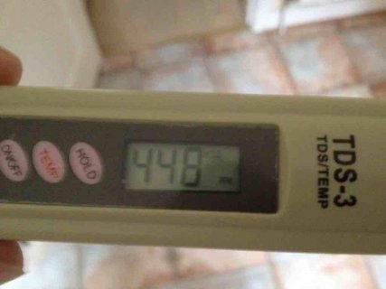

Yep, it's a TDS meter I'm using. Just looked back through my photos and found 2 I took at the end of 2014 when I got a filter from More Than Polish. Water out of our tap:

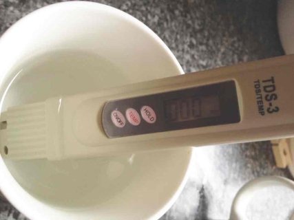

Water once it has passed through the filter:
Pretty much the best advert I can give - it was 100% effective :thumbsup:

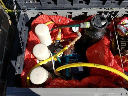

What we have here is a single pre-filter, feeding a 5 bar pump, which then supplies the GE Merlin unit, which comprises one plain filter, then two R.O. filters (the 3 white units) and finally into the resin based de-ionisation filter, the whole system is supplied by an Ion Exchange water softener:thumbsup:
