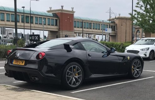

So car is back now just in time for summer - aircon system now has a better efficiency with the new compressor but the U.K. weather won’t test that much. Hoping for some epic trips now as we haven’t been to Italy since last summer and need to get to the farm to see how things are.
Watch this space
That's looking well Mod, Traffic Centre to boot! That's brave (shopping) in any car :laugh: Despite living barely 15-20 minutes from the Trafford centre I do not remember when I last went.
